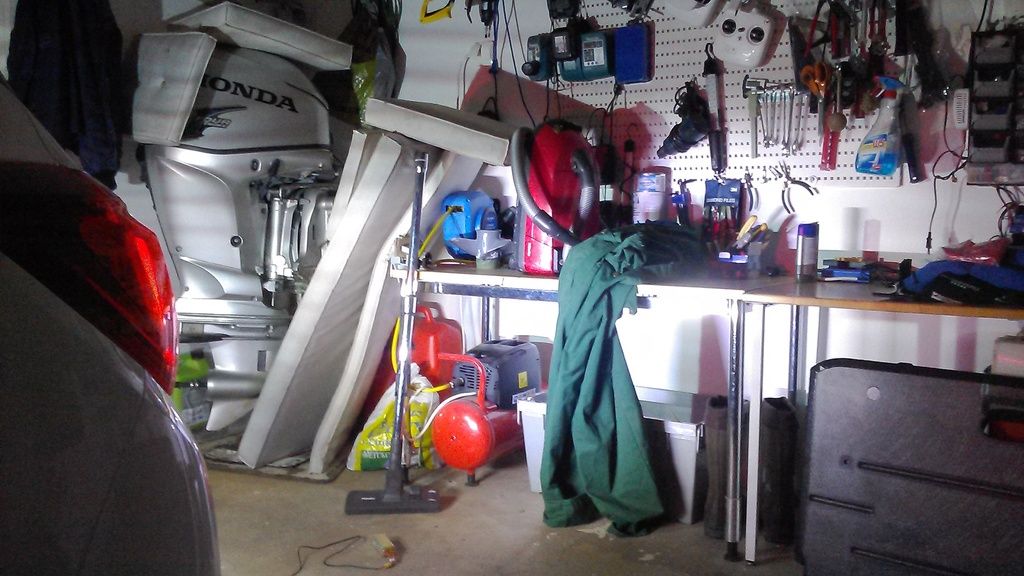

Replaced the OEM incandescent 1156 bulb with a 15W xenon bulb. It is quite ok, but since its a xenon, it to reach the max brightness takes approx 10 seconds. In Vauxhalls, is the reverse light on drivers side?
Added 2 LED lightbars on top of the register plate. Needed to drill only one 5mm hole to pass the wires thru the bumper. There seems to be a way to pass the wires thru to trunk. Wiring part is WIP
Some pics

I believe that on the Corsa the reversing light is on the passenger's side and the rear fog light is on the driver's side.

Oh, in that case I need to search for Vauxhall Corsa´s passenger side inner taillight and swap that with rear fog light. Rear fogs are very seldom needed in Finland.
